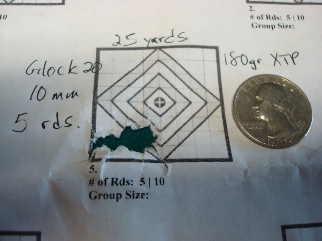

Originally Posted by gofly View Post
My old Lyman book generally cited a powder for a given cartridge as having the best accuracy with full power loads, but it isn’t very good at 10mm.
To narrow it down, let’s make the slug either a 180 or a 200. I figure 180 as the best all ‘rounder, but get a sense that the 200 might help smooth out the velos and tighten the groups.
From observed velocity spreads, I’m guessing it’s not BD, at least not when at full power under the 180. In the winchester sticky, there are good words about WSF under 180.
Anybody?
From a bench, aka hood of truck.
1.26 inch COAL
13.8 to 14gr of AA#9 *I made some of both, but mostly I make 13.8 now.
CCI 300
180gr XTP
Starline brass
10mm Reloading Forum
"The Centimeter Magnum of God."
-Berto

Nice group, Oregon.... What velocity do you get with 14gr AA9 / 180 XTP?
1.26 inch COAL
CCI 300
180gr XTP
Starline brass
Sweet group. That is a winner right there!

Beautiful group, I'm curious about velocity with that load too.
Thanks for all the compliments guys. Even a blind squirrel finds a nut now and then...lol
They were chrono'd at 1200fps.
I don't own a chrony, and my friends seems a bit on the slow side. All my Hornady .223 rounds were 200 fps off of the box flap, and I have a 26'' bull barrel on my rifle, which is longer than the 24'' test barrel from Hornady. I always thought Hornady is usually pretty accurate. He was getting some weird readings from his .357 magnum too that day. Could have been the setup. Or the weather. It wasn't much above freezing that morning in Central Oregon. A lot of people have run the same exact load across a chrony and swear it's in the 1250 fps range. Until I try it on a different chrony and get a different result, I am sticking to the 1200fps though.
The 13.8gr @1200fps muzzle energy = 575 ft/lb
If it were 1250fps, it would = 625 ft/lb of energy. I never got to see what the 14gr were doing. I assume a bit faster....lol.
*edit* BTW, Accurate Arms reloading manual states 13.5 gr of #9 is max with 180gr XTP, and out of a 5'' barrel, they say it does 1242 fps. So, if anybody wants to take a guess at what subtracting .4 inches of barrel and adding 3 or 4 tenths of a grain of powder probably equals, be my guest.

I won't guess on the barrel but it is possible that the additional powder could result in lower FPS. There are diminishing returns.
