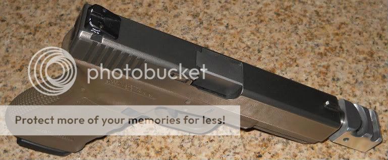

Originally Posted by vaquero aleman View Post
Well, I finally went "all in" and converted my G21 to 460 Rowland. But I seem to be having the same feeding issue, that I did with 45 Super, so I ordered an 11 coil magazine spring. If the extra power mag spring don't help then I guess I'll spend the money and get the $95 Sprinco Cor Bon unit.
That is badass! .460 is an asskicker fo' sho'!

My 45 Super Gun!
Better late than never, I guess.
