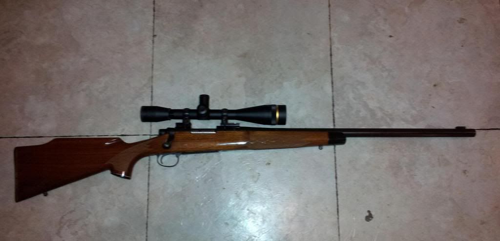

I actually have two 308s, the FNAR above and a 3Caliber Corner or 4 decades old Remington Varmint Master. I had a fixed 10 power el paso Weaver on it for years. it lately gave up the ghost and I replaced it with a fixed 12 x Leupold FX-3 target rifle scope on it.
