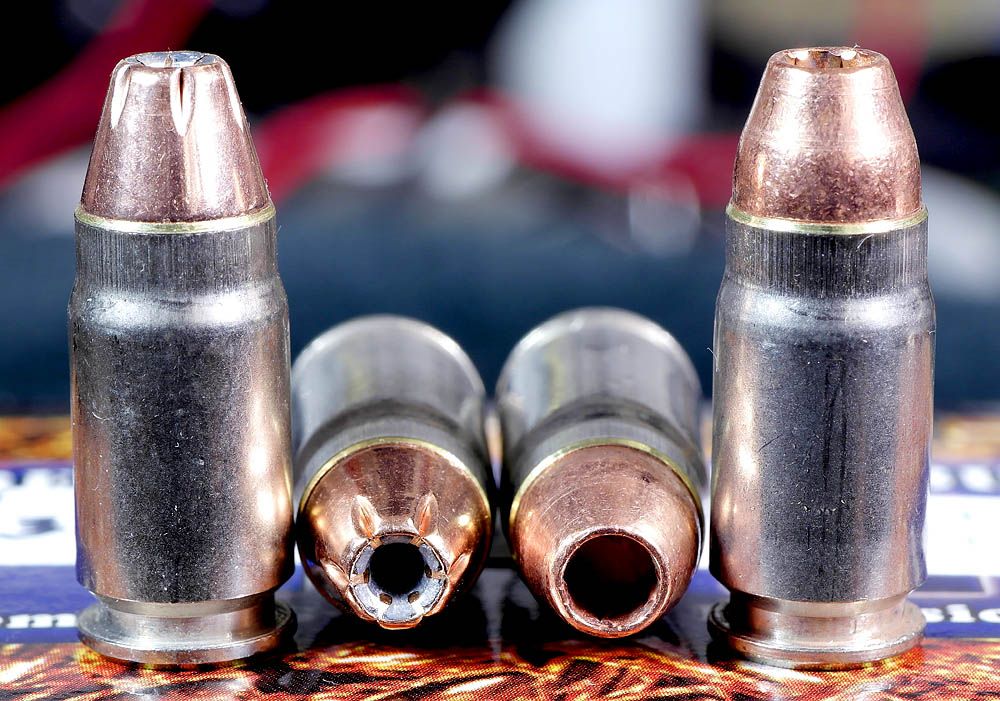

Original (stock) Lee 3-piece die set. I set the seating/crimp die to have a distinct pressure at the shell's height without belling the case--but then I run ALL my COMPLETED reloads thru an empty .40-cal sizing die anyway.
As you can see, I outside-chamfer all case mouths; that seems to help them feed more easily. All my reloads, with XTP124s, Barnes TAC-XP125s, or Montana Gold 125HPs, feed and function absolutely perfectly. Both former loads achieve about 1400FPS 10-foot velocities from a 5.2" barrel; my practice loads* achieve about 1300FPS.
* in which I use all the powders I bought a pound of and then rejected for PD loads. Currently I'm consuming VV 3N37.

I might give that outside chamfer a try. I've used up all my universal for targets. I'm trying out accurate arms #5 now. I do have a lb. of vv3n38 but with no data for 357sig.

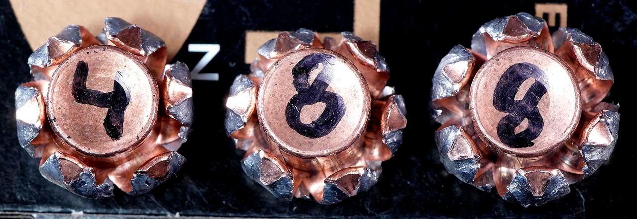

Shooting results
Tested these Speer GoldDots #54234 this afternoon using my Glock 31Gen4.
Velocities at 10' average screen distance, 10-shot samples:
...With 5.2" StormLake barrel--1384FPS, SD 6.0, ES 20.
...With stock 4.6" barrel--1356FPS, SD 3.0, ES 12.
Recognizing that Speer quotes muzzle velocity (1375FPS), these numbers make sense. The Standard-Deviation and Extreme-Spread numbers are VERY good.
Expansion tests in a series of four 1-gallon waterjugs with 4 or 8 layers of denin taped to the front of the first jug, shot from 10 feet:
Lightest bullet weighed 123.4g; the 3 averaged 124 grains, which makes the weight loss less than 1%. 'Diameters' were 0.58", 0.60", and 0.62 inches. The 4 versus 8 layers of denin made no apparent difference.
Muzzleflash is virtually nonexistant.
I shot about 40 rounds; they functioned 100% reliably. I'm pleased.
Also, my experimentation with these GoldDot 125s, the Hornady XTP124s, and the Barnes TAC-XP125s show that all 3 bullets perform excellently, and I'd be proud to carry any of them. Now, I'll be carrying the GoldDots.

Awesome report!! Thanks. I guess your water jugs don"t become ice jugs there? Freezing rain and snow here tomorrow......again....

No ice in Phoenix; it rarely gets down to freezing. But when it's maybe 80dF. in Penn., it's maybe 110dF. here.
One added point--over the years I've shot many GoldDots into waterjugs; they are highly consistent in their expansion and weight retention.

I am amazed at your results through denim. I have never seen over 0.56" in expansion through clothes for factory rounds, and I believe the FBI testing in gel through clothing was in the mid .50". The Underwood round does expands to about 0.64", but has much more velocity.
