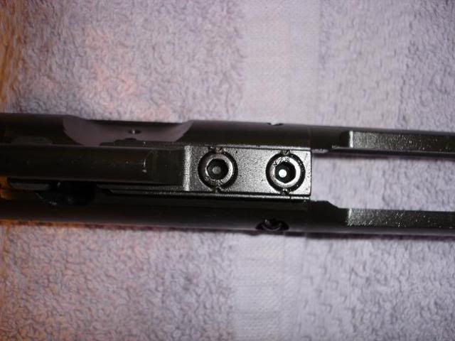

got in my stag upper a few days ago and got around to pulling it apart today. I know the castle nut on the buffer tube has not been done at all, but how does this look?

I'd be fine with that staking job.

I think Stag staking has gotten better recently, but I still like it done a little more than that.
That is better than nothing though.

I'll probably get flamed for this but.
Some of my unit's older Colt's look about like that, maybe just slightly more.
I wouldn't worry about it in the slightest. I might do a better job of it, if you were going to do the other one. That said, my castle nut isn't staked either, just torqued.

I'm not sure about now,...but for a while ArmaLite was only using LockTight
and torquing them. A friend in Georgia has a rifle that is done like that, it has 7k rounds fired without an issue.

That staking is fine. You can see that the inside of the hole has been deformed to provide friction against the screw, which is the whole point. I like the staking my PMOAKS does better, but yours is fine.
As far as staking the castle nut, get a spring-loaded center punch from a hardware store. They are usually about $8. Grind the tip down (I used a Dremel) so that it's rounded, and go to town staking the end plate into the castle nut indentations. Slow and steady is the key. With my center punch, I usually need 20-30 impacts to achieve one stake.

Leave well enough alone, check it when you clean. That should hold up for quite some time. Last thing you want is to deform the rails that run alongside the key...

Looks fine to me as well.

Looks good enough to me.
Black Rifle Forum
Not good enough. I had to stake the bolt carriers on both of my previous Stag builds. the bolt itself should be pushed in a bit from the metal on the carrier.
