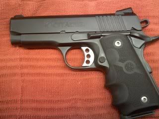

Originally Posted by awpk03s View Post
I had a CBOB done by him. It was okay, but in all truth I wasn't completely satisfied with the appearance of it. Some of the Melonite and IonBond guns I've seen are much nicer looking.
Do you have any pictures of it? I would like to see a true picture and not something from the website.
Old 12-08-2010, 19:35   #20
awpk03s
Join Date: Apr 2007
Location: Ohio
Posts: 1,387
Here you go...
awpk03s is offline   Reply With Quote
Old 12-08-2010, 19:48   #21
thecableguy
thecableguy's Avatar
Join Date: Jun 2010
Location: Lewis/Vine TX
Posts: 2,066
Thanks Awpk03s for the pictures but I have to ask why are you not happy with it? To me it looks great, but then again I am only looking at a picture.
Old 12-08-2010, 21:01   #22
awpk03s
Join Date: Apr 2007
Location: Ohio
Posts: 1,387
There were a couple of smudge like marks - almost like fingerprints - in a couple of places on the slide. It looked very durable and all that, but the smudges would not come off no matter what.
