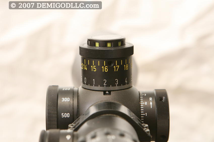

Scope dialed to 2.2 mils (actually 16.2 mils)

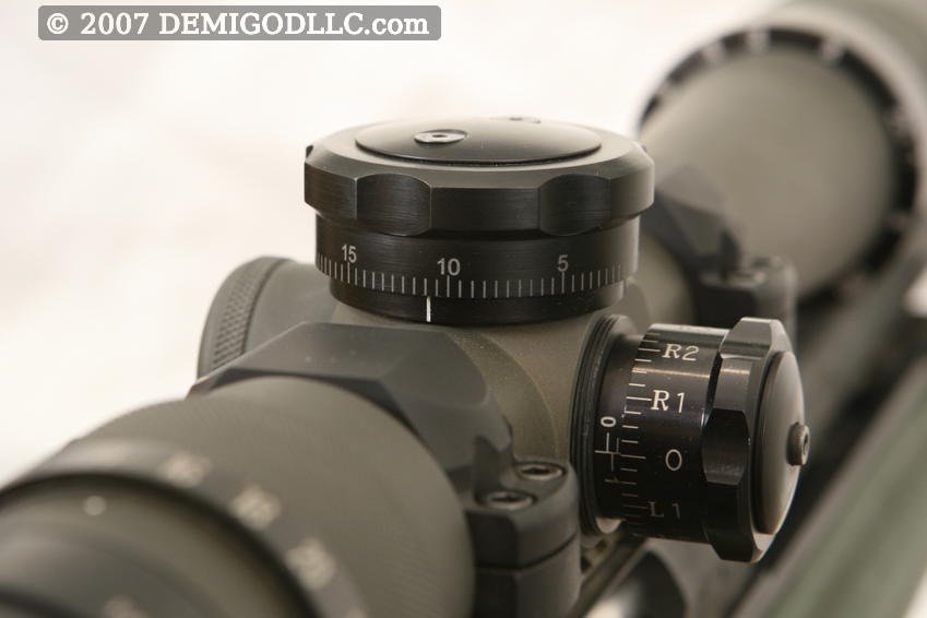

Scope dialed to 11 minutes

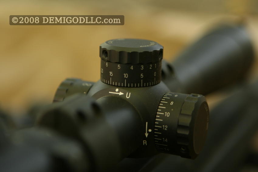

Scope dialed to 12 minutes

Thanks again for all the info. I kind of get it now. I was a little confused by your first pick of the 11 minutes, until I realized that scope is 1/2MOA clicks. I couldn't figure out at first why there were so many hash marks between 10 and 15.
I had to go look at my scope to get a better idea of what you mean by not thinking in clicks. I do have hash marks with even numbers, and 4 hash marks between each number, and 12MOA of adjustment per revolution. Under the turret, there are also marks on the column with lines. 1 and a line, 2 and a line. Not sure what is above that but my scope is zeroed on the 2 line. What do these lines mean? My owners manual isn't clear on this. I'm guessing it's to count the revolutions, for easy multiplication, so the 2 line tells me to multiply my clicks by 2, for 24 MOA, so my scope is zeroed just about dead center of it's mechanical zero. Is that what these second set of ticks are for?

The horizontal lines indicate the revolution the knob is on.
