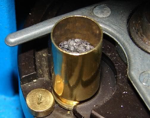

Bullseye is fine but there are slower burning powders that will fill the case more and make the possibility of a double charge less likely.
Reloading can be dangerous, if youre carefull and look in every case, know what a proper charge looks like and know what a double charge looks like and you will be fine.

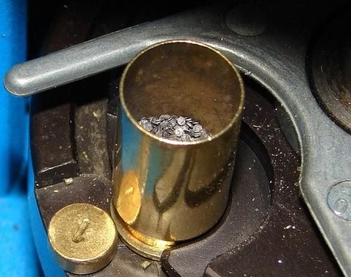

Here is an example in 45acp, the difference will be even more obvious in 40
This is 4.0 grains of Bullseye, the thing to notice is the distance from the top of the case, down to the powder
This is a double charge, 8 grains of bullseye
