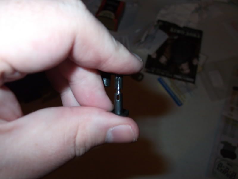

possible I have the opposite I just removed the safety completely and I found the Male and female parts don't mate together. There way to tight here a picture of what I am talking about. my next question would be if they are way to tight do I sand down the male part or stretch the female part. Sorry about the terminology just what I was taught to call joint fittings like this.

Sand down the maie (aka tongue) side. Make sure you do it evenly on both sides as to not off set the pin, when both sides are together.
Get some diamond files and take only a few swipes on each side. Make sure it goes together snugly to avoid being too loose and then you're SOL.
1911 Forums
That will cause that side to be too large and you'll have trouble of putting it back on the frame pin hole.

Fixed a few swipes with a file and its snug tight both sides work great. Thanks for the help I really appreciate it. Hate to admit this but kinda glad this happened. I think I will feel a lot more comfortable now putting in a single sided safety later down the road. I guess I had it built up in my head that its extremely delicate. While you cant be bull in a china shop its not china either.
