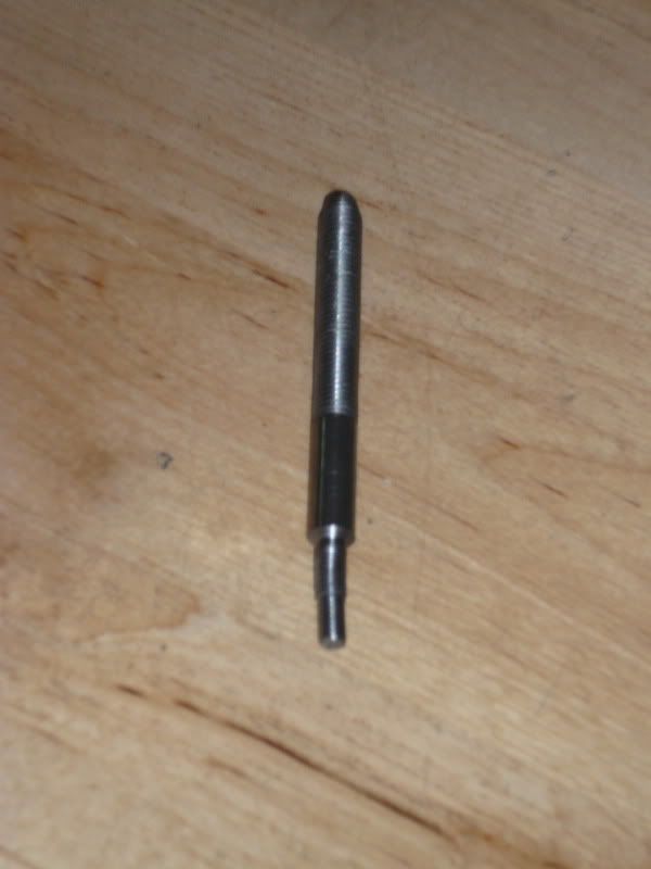

Well it has not been a good week for me and RCBS. Bullet puller broke Saturday. Even without over crimping the seater is still gouging my bullets. This is my 1st set of RCBS dies. The deprimer pin on my Lee dies will push out the top of the die if there is to much tension on it. Not so with the RCBS dies. Bent the rod in the middle of the resizer/deprimer die.

I think the only pins I have ever bent have been RCBS.

I just ordered another set of Lee dies. I've had good luck with them in every other caliber I shoot. The RCBS dies will go up for sale after I get a new rod.
