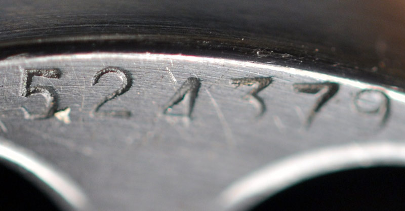

Well the first number #74986 is from the frame behind the crane, but you are right there is another number on the rear of the cylinder #524379, but what does that mean?

The serial number should be on the bottom of the grip frame. It was probably removed when the grip frame was modified. No big deal since the work was probably done before the gun control act of 1968. Prior to that serial numbers were not required. For some reason S&W has always used serial numbers even though there was no requirement to do so.
In addition to the grip frame S&W also had the serial number on the cylinder, barrel and grips. Assuming the cylinder is original to the frame 524379 dates that revolver to 1915-42 time frame. This would confirm it as being a .38 military and police model of 1905 4th change.
The only way to narrow down the date is to request a letter rom S&W that will detail the date the revolver shipped and where it was shipped to. They do this for a $50 fee and more info can be had at the S&W web site. That gun is interesting enough that I would consider doing so if it were mine.

Thanks Penn, this is great information. But what can be said about the serial behind the crane then? And if the cylinder is original to the frame, why the different numbers?

The number behind the crane is a part number. S&W's from this time frame did not have the serial numbers behind the crane. I have 4 pre model number S&W's and they're all this way. Open the cylinder and check under the barrel to see if that serial number matches the one on your cylinder. You can also find the serial number stamped on the back side of the extractor star. Just push it out as if you were ejecting spent brass, you'll see it. If all 3 of these numbers match I'd say that chance are that is the number that was on the grip frame. Please post if all these match, I'm curious.
ETA: Check under the grips for a serial number too. I have a feeling these are the original grips sanded down. It should be on the right grip. The barrel as stated before I doubt is original to the gun.
