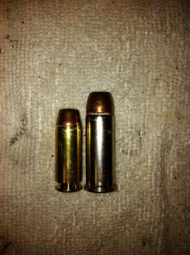

I am pretty sure that the pit bull is built on the same frame, and using the same cylinder as the .44 special Bulldog Pug. That being said, below is a pic of one of my 180 grain Remington Golden Saber bullets in a 10mm Starline case. I laid it on top of the cylinder. I also took a picture of a 10mm round next to a .44 special round for comparison.
The 10 Ring
The 10 Ring
PBRLite is offline   Reply With Quote
The 10 Ring
The 10 Ring
What 'smith are you going to use for the reaming work? And what would a reasonable cost be for such work? Thanks.
