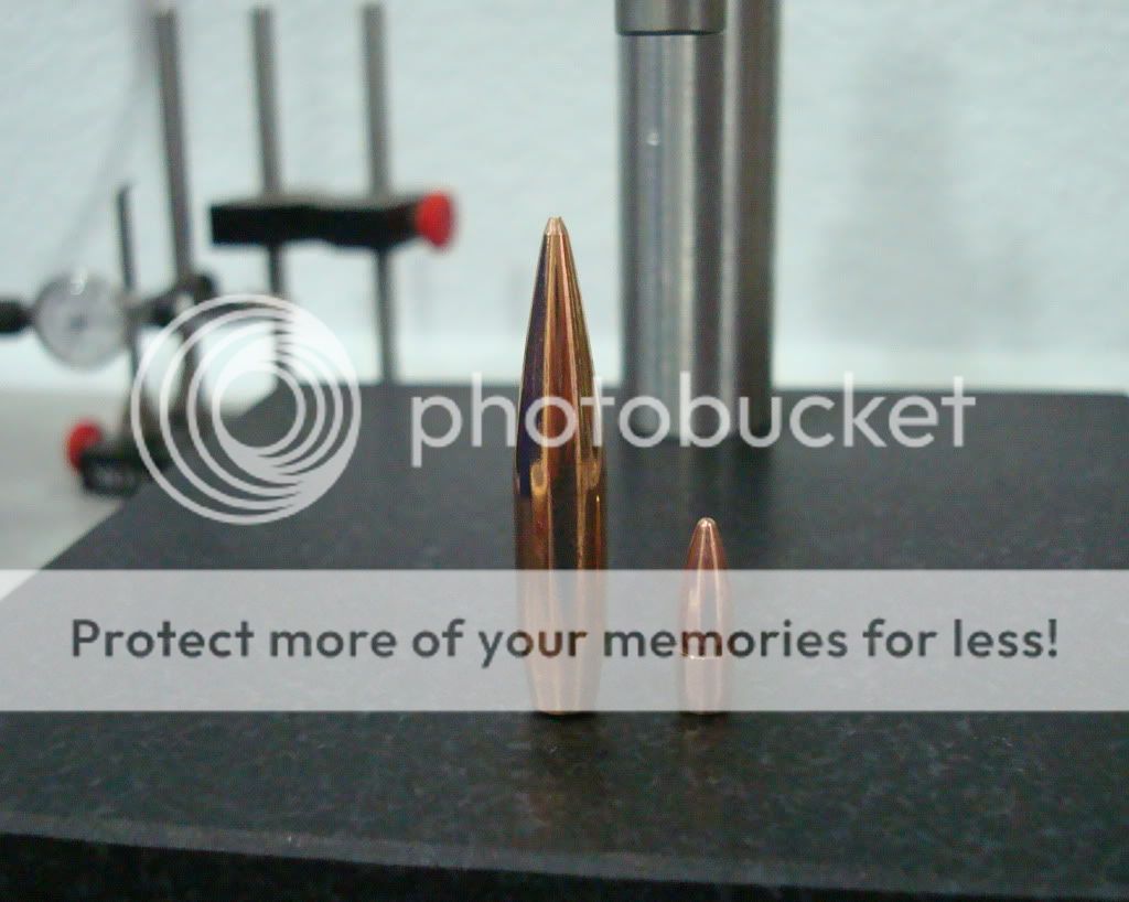

I did not sleep well last night and I woke up early. I figured I might as well find something quiet to do in my reloading room. So I started pointing bullets.
The goal is to make the hollow point on match bullets smaller and more uniform. This makes the ballistic coefficient more uniform and it is one more variable I can control.
Inside 500-600 yards it doesent make much difference, but it cant hurt and might help.
I use the Whidden pointing die. Works like a charm.
http://www.6mmbr.com/bulletpointer.html
Sierra has started doing this to some of their new bullets like the 308 125gn and 155gn bullets and 6mm 115gn bullets. I would guess that within a few years all their Matchkings come pointed.
I did 2,500 123 gn 6.5mm bullets and 500 Berger 300gn 338 Lapua bullets. I can do about 1200-1500 an hour. Boring as hell, but easy.
Pointed vs non pointed.
A 300gn Berger 338 Hybrid bullet next to a 55gn FMJ...

I take it you did not read the referenced article? I have done testing at long range. Trust me, I have other things I can do with my time instead of pointing bullets. If it didnt work I would not be doing it.

Any thoughts on how to back in to a BC after point-trim-repoint?
I would really like to have a revised BC to use when preparing range tables. I could just shoot the ranges we have available: 100, 200, 300, 500, 600, 800, 900 and 1000 yards and do a curve fit I suppose. But the problem is that this would all be based on my shooting which is dubious at best.
Richard
F106 Fan is offline   Reply With Quote
Old 12-01-2011, 12:00   #16
Hoser
Mall Ninja
Hoser's Avatar
Join Date: May 2002
Posts: 2,130
That is exactly what I do. Computer data from places like JBM, Litz or Sierra is fine, but I always check it.
I have found the BC comes up a few points. I usually compansate by adding a little velocity to my data cards. Comes out pretty close in the end.
