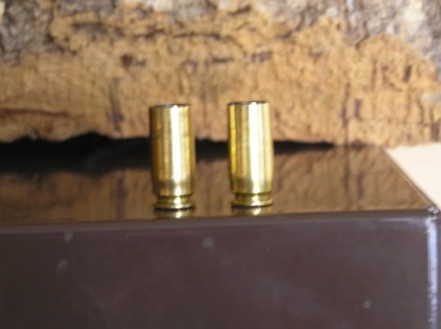

I should add that BULGES are ok, and will iron out with no problem. Only SMILES will ruin the brass. Every round I've ever fired through my G29 has bulged the brass. That's no problem. Here are some pictures for clarification:
These first two show bulged brass (kind of hard to see) that was from factory American Eagle 180gr FMJ. This is ok:
These next two show actual Glock smiles, that are RUINED brass.
This first picture shows two pieces of smiled brass (on the sides), with two marked rounds in the middle (ignore the middle rounds, the marks on them are from a marker and needle:
The piece on the right was DANGEROUSLY close to causing a KB. This was from a load that had tested safe in my G29's stock 3.78" barrel (135gr Nosler JHP @ 1575fps). When I tested it in my 6" LWD G20LS barrel, I got the following. I thought the "full support" would keep smiles from occurring. It appears my barrel lacks full support. This is proof that a load that's safe with a short barrel is not always safe in a long barrel. These 135gr Nosler JHPs averaged 1800fps flat:
ALL OF THE ABOVE PICTURES WERE EITHER MY HAND LOADS OR FACTORY AMERICAN EAGLE. NONE OF THE ABOVE CAME FROM UNDERWOOD.

Ok - so is underwoods ammo safe if it is doing that to the rounds?

Those pictures were MY HAND LOADS, NOT Underwood ammo. Many people have shot Underwood ammo safely. Smiles are the first sign of overpressure. I'm not saying they are not safe, but it sounds like they are getting close to the limit. If only a few of the rounds cause smiles, I wouldn't worry about it. If ALL of them show smiles, I would consider an aftermarket barrel, or at least a heavier spring if you're gonna shoot it a lot.

That is almost exactly how my recovered brass using the factory Hornady 155 gr. XTP and my handloads with same bullet looks.
Federal 180 on the left, Hornady 180 XTP on the right:

My recovered brass always looks like the one on the right, the one on the left looks to have slightly more buldge, but could be identical.
