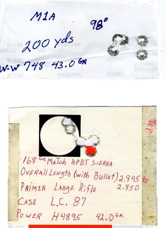

Steve,
The most I've gotten out of any brass for the M1A, has been 6 loadings.
(I'm very meticulous with this rifle/brass combination.)
The very best groups have been with LC87 and Federal GMM brass. (I know. I'm the only one around here that likes Federal brass.)
Here's a photo of a couple of groups fired from a Bull's Bag, with my M1A.
The groups with W748 are a LITTLE tighter (and more 'round') than those with H-4895.
Reloading
The 'circle within a square' is 1" circle. 1" square.

Those are some fine looking groups. Is that M1A a standard service weapon or a Match grade?
Seeing those targets makes me want to spend a little more quality time with my M1A. I have some LC brass (it's in storage, I have no idea what year it is nor do I know it's pedigree) and I have some Federal Match that is probably close to end-of-life.
I'll be very interested to see what commercial brass can do. Something I can actually buy...
Richard
Match rifle.
This rifle started life as an 'early' Standard, then was accurized by Mr. Charles Maloney.
I bought this rifle from a good friend, that wanted something 'different'.
This rifle weighs in at just a couple of ounces shy of 15 lbs., rifle/scope/mount/rings. No magazine or ammo.
It's a fun rifle for shootin' groups. I sure wouldn't wanna hump this rifle on a 20 mile march!
