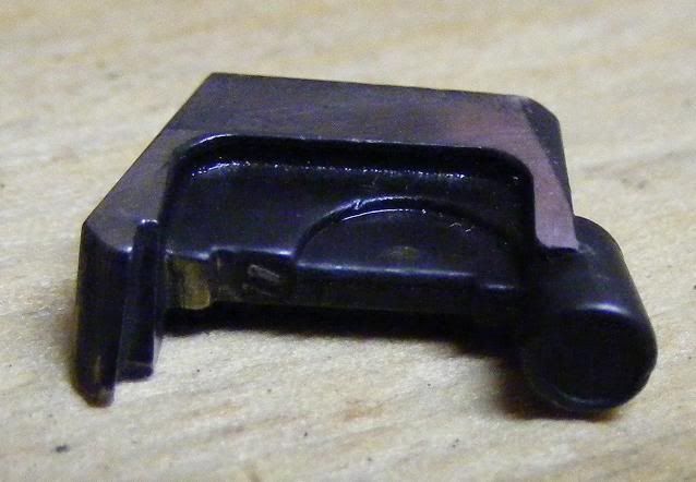

That post says that the numbers molded into the stem of the extractor indicates what caliber it is for ... not always the case.
I was cleaning my 27 and noticed that the extractor was a number 3, I thought I had accidentially swapped hooks with one of my 9 mm pistols. When I checked the profile of the hook I found it was the tapered style designed for the .40 S&W.
So be sure to check the profile of the extractor when swapping them around.
Could it be the tapered face of the .40 extractor allows it to get a better bite on the 9mm case, making it easier to pull the shell case out of the slide?

voyager does explain the numbers on the extractor mean nothing if it's a glock part. it's relevant only for a lwd part.
i believe the tapered claw is what cured my ejection problem. with the stock 9mm extractor, i would get a lot of black deposits on the left and right side of the breach face after 150+ rounds at the range. rounds 1-150 would eject normally, then the ejections would get progressively worse. with the glock 40sw extractor, i find very little deposits on the breach face even after 300 rounds, and all casings are held firmly in place.

Shot my 26 with the 33 round mag today. I had previously polished the OEM extractor. As in my last couple of range visits, no ejections to the face, a couple casings went high and right and the rest went to the right at 3 to 4 o'clock.
I shot CCI Blazer aluminium case 124 grain rounds. Normally I shoot WWB 115 gr.
I do believe that the "cure" will take care of 90% of the "erratic ejection" issues. Leftover problems IMO are likely caused by magazine spring tension, weak ammo or even the limp wrist.
I am still going to expierment with the non-LCI extractor and bearing, and may purchase the .40 caliber extractor as well.
I also shot a friend's newly acquired GI 1911 .45 along with my Glock. Just about every case went straight up and bounced off my head or ball cap. It could use some tweaking as well!

did you only polish the OEM 9mm extractors top and bottom
or also the round knob
or the "step"
or the claw?
did you also change the ejector?

If that was directed at my Glocks ...
Polished top and bottom of the OEM extractors, did a general polsih with 1500 paper of the "round knob" but haven't really touched the step or claw.
I ordered the new ejectors from a local Glock armourer, but not sure when or if I'll ever see them.

I just had the new ejector put in my new Glock 17 Gen 3, replacing my 336 one at my local glock dealer today(glad I did not have to send it to glock). I haven't had the chance to go shoot it yet. I am not holding my breath that this will fix it though since a lot of people still have issues with this new ejector.
Has any one tried pulling the extractor from a glock 22/23 to see if the glock .40 cal extractor helps?
novasquid did, he had to file part of the claw down a little to make it work. Every other person I've heard from who's tried a .40 extractor in a 9mm Glock said it dropped in and worked just fine without modification, and it fixed the ejection problem.

I've been lurking here for awhile, and thought I'd add my experience with this fix. I have a Generation 2 1/2 (finger grooves but no rail) G30 that has always spit brass all over the place. My extractor has a small number "11" molded into it as seen in the picture below.
I polished the top and bottom of the extractor first by laying 320, 600, and then 1500 grit paper on a piece of glass to keep it perfectly flat. Testing at this point showed no difference in ejection pattern, but the extractor did move more freely in the slide.
I then filed 0.005" (measured with a micrometer) of the step that's been talked about so much here. At this point the ejection pattern looked very good, but I had several failures to eject in which the empty brass was extracted cleanly, but lodged between the slide face and top of the barrel. Maybe the extractor held it TOO firmly now? I guess that means 0.005" was too much to take off in my case.
I'll be ordering some more parts and starting from scratch I guess. Oh well - nothing ventured nothing gained.

Just got new non-LCI spring loaded bearings, and mounted them up in my two 9 m/m Glocks (26 & 19) ran some dummy rounds and they ejected cleanly. Will try this new/old set up next week.
I do think that even with the best functioning extractor and ejector, the magazine spring and ammo still plays a role in this issue. I'm hoping that going "retro" with my extractors, provides the most reliable "fix".
My big complaint is that the extractor is a pretty expensive part for a Glock, otherwise I'd hedge my bet by buying two for the .40 caliber.

I may have spoken too soon. The test with the FTE's mentioned above I did with two 13 rd G21 magazines that I haven't used much. I wanted to run as much ammo through the pistol as quickly as I could pull the trigger, so I used my hi-caps.
I just repeated the test with two known good 10 rd G30 magazines. The first magazine was loaded with all the same headstamp (everything I shoot is reloads, typically with mixed brass). Shots 1-9 ejected perfectly at 4 o'clock, and the last shot ejected back toward me.
The second magazine I filled with mixed brass. The ejection pattern wasn't as repeatable as with the uniform brass (of course), but it was much improved over how it's been in the past. There were no malfunctions with either magazine.
Twenty good rounds doesn't prove the rule, but it sure does look better. I'll keep shooting and see how it does as I put more rounds through it. Thanks to everyone for posting here!

Seems as if the more I do to my Gen.3 (12/09) 19 , the worse the ejection gets.
At the first I got a few crazy ejections per mag. Polished the top and bottom of the extractor and things got worse.
Removed a very small amount from the step and still no change, more crazy ejections.
Today was the worse I ever had. Empty cases went everywhere. Left,at my feet,over my head,right forward,in my face and a few where they should be.
Had a 8ft.X 10ft. tarp spread out to my right to ease my brass pickup and had more cases off the tarp than on it.
Wish I had left well enough alone with just a few cases to my head instead of trying to fix it.
