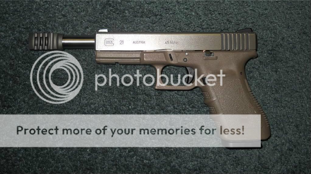

Old 04-14-2012, 07:40   #18
vaquero aleman
US ARMY 63D20H8
vaquero aleman's Avatar
Posts: 447
Don't hold me to it, but a little birdy, from LWD, told me that a new offering is on the table. It is possible that very soon barrels chambered for .460 Rowland will be available. Hopefully there won't be any legal snags and all of the technical stuff will be worked out, then somebody will have to start a new club.
US Army Veteran, The 21 Club #7663, The 10 Ring #7663.
Amateur Glock Modification Expert
vaquero aleman is offline   Reply With Quote
Old 04-30-2012, 06:16   #19
vaquero aleman
US ARMY 63D20H8
Posts: 447

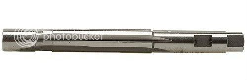

Got my barrel, but LWD told me that they could not ream the chamber, bummer.
So I ordered this:
45 ACP pistol chamber reamer from Brownells, for $78 to my door, we shall see...

That is one shinny compensator. It needs to be dirtied up a little. :-)

vaquero aleman
US ARMY 63D20H8
Posts: 447
Well, Hot Dog! I finally got this thing licked! The only thing left is to "pull the trigger". The Clymer 45 ACP barrel chamber reamer did it's job, although if it is not precisely the way it should be I won't know, because I am not a gunsmith(woops). Regardless, the 460 Rowland round fits just the same way that the 45 ACP did before I started cutting. So, here's wishing me luck when I go to the range.

Finally got some range time(G21 converted for .460 Rowland):
I ran a very conservative trial, only 14 rounds, Georgia Arms is in thier "out of components" mode with the .460 Rowland right now so I didn't want to leave myself short on ammo. Of course, Johnny Rowland claims that a person can shoot 45 Super or 45 ACP out of his .460 barrels, but I just don't know if I want to do that. There is a 1/16" gap between the mouth of the case and the throat of the chamber, if you load 45 ACP into a .460 Rowland barrel.
The Georgia Arms 230gr GDHP @ 1300fps shot very well out of the LWD barrel(reamed out by myself, a "non-gunsmith"). I really need the time and ammo to make a decent assessment, but I can say that I am no longer worried about how it will shoot. It shoots great. The round will definately get your attention. I couldn't believe the size of the holes that it made in the paper.
I did have several FTF's so when I got back home I immediately changed the 24# out for the 22#. I am hoping that the reduced spring weight will stop the FTF's but I have to shoot it to know for sure. The FTF's occured with and without the comp installed, so I am assuming that the 24# spring was too much for the slightly weaker Ga Arms ammo. And I had to go ahead and threadlock the comp(I am not going to tighten down the set screws, as the comp is made of aluminum) because the .460, on the first shot, loosened the threads enough to spin the comp and it was pretty tight when I screwed it on.
It was not as violent as I was expecting, so I guess the comp is a help. Again, much more shooting needs to be done. But, you definately know that you are shooting a hot round and I imagine that the 24# spring dampened the slide more than I am allowing for it. With this round you definately want to be paying attention each time that you fire. I can't quite figure it out, but even though the .460 is much more potent than the 10mm, it just didn't feel like the "smack you in the hand snappiness" that I experienced with the G20 that I had. Of course, I left the factory stock spring in the G20 which probably accounts for most of the slide smacking.
***The modification that I performed on the extractor worked very well also. I removed the depressor plunger spring, cut about one and a half curls out of the spring(about the thickness of the bearing head) and re-installed everything. The brass landed exactly where it should, out to the right. Hallelujah!
