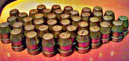

what is you most accurate 180gr load?
Im trying to get something around the 1200fps mark that I can make a lot of quickly and cheaply.
Im working with Lee truncated cone 175gr lead bullets.
The bullets weigh 177grs when sized and lubed, the mold has had the bevel base removed.
Id like to run them plain base if possible, but I can gas check them
Low pressure is a big plus, as is a slow burn rate (I use a comp)
Im thinking either 13ish grains of AA#9, 10.5ish grains of Blue Dot, or 9.2grs of Longshot,
I also have WSF, Unique, and AutoComp, but I think those are faster powders and if pushed to 1200fps may cause leading and/or accuracy issues.

1200 FPS with the 180 gr. (or 175 LTC) is easy. Any of your first suggestions are simple, clean, and not punishing. You can also get there with some of the faster powders, but as you said, occurrences of leading increases. 1200 isn't asking much. I like BD for this, and 10.x gr. is a good place to start. You can have 1300, if you want, for a little more without much effort. Plain base or bevel, doesn't seem to make much difference. Very accurate with BD, LS or AA9.

I shoot the same bullet in 40's at about 950fps Nice flat meplate. Excellent shooting. Mine have been weighing in at about 182. Might be a bit soft for the 10 but I haven't tried them.
