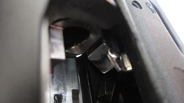

Here's a picture of the GlockBlock as it sits outside. It came as a dull colored steel like the locking block in the background.
The 10 Ring
I polished it up hoping that the surface is so slicky for bullet heads to slide on.
The 10 Ring
Actually, it functions more like a bouncer, bouncing the bullet towards the chamber.
The 10 Ring
The 10 Ring
The 10 Ring
Yup, that's the surface i was talking about that should be reshaped so it doesn't deform the bullets. Most all of the bullets i've pulled out of the chamber were deformed by slamming into this surface. Not cool.
Did it deform hard cast or jacketed bullets ? Or both ?
