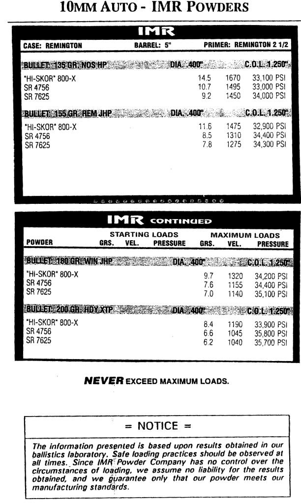

I just got done loading up 11.4grains of 800x using cci 350s (magnum primers) to push 135 grain noslers. My forecast was that they would have been going 1600 fps.
I ran a relay of 15 each (1) relay with a light crimp and the other with a medium-heavy crimp.
First of all, the velocity was all over the board on each relay. Secondly, I had a few failures to read with the chrono.
The relay with light crimp ran 1549 - primers flat, but okay.
The relay with medium-heavy crimp ran about 1620 on avg., and had 3 primers (out of 15) blow out. I also had about (3) fail to extract - to the point of having to extract them with a pocket knife - they were wedged in the barrel pretty bad!
I regret having loaded 50 extra of these today. Oh well...brass are going to be fried afterward.
I tried running these loads before with the 11.6 and 11.8 grains both light crimps. 11.6 was okay, but 11.8 was too much (primers blew).
I don't think cci 350s are good at all with these 135gr. loads.
I'm also going to go with a slightly lighter crimp on all loads.
I just think the magnum primers spike the pressure on these loads. Even though they were great with my 200xtp loadings, I think from now on I am going to go with cci 300s for almost everything with this powder and see how much I can work up with that.

This post has me scratching my head. I have loaded up to 14.5 grains of 800-X (standard primer) with benign pressure symptoms. All with a sloppy Glock barrel. Velocities are 1695 fps. Yet you are getting blown primers at 11.X grains. Do you have any photos of the primers?
I do not shoot loads anywhere near 14 grains any longer under the 135 grainers. Not because I've had any issues, but it just doesn't make sense that it is a safe load. I'm wondering if with the compressed charge levels if I was getting an incomplete burn and that is why I wasn't building sufficient pressure to cause concern. I did not find any evidence of unburnt powder though. Weird. This is why I am not too enthused about this power/projectile combo any longer. A lot of anecdotal information that keeps me confused. I wish that I had chronographed velocities of lesser charges during my workups. That would have provided helpful data. Who knows.
I have several test batches at lower charge weights. I'm going to reduce to the latest max charge for the 155 grain as a starting point. We'll see what happens.
I agree with trying standard primers. Mag primers have always presented pressure symtoms at lower velocities that standard primers. That is accross all bullet weights.
I don't have any photos of the primers, Tater - Those bad boys fly out pretty good once the slide opens - one hit me in the head a couple weeks ago.
I honestly think that the huge difference is the primers. I think the magnum primers seriously make a huge difference in this load - and it's not a good one.
I would like to load up some 300s in some cases and do a work up with the 135s. I still have a lot of 135s left unloaded.
Unfortunately, I have a lot of them loaded as well - I really hate to pull them, but I might.
With the mag primers velocities were all over the place too - from 1400 up to well over 1600. SD was triple digit!

Used Remington 2 1/2 primers and I got some serious velocities out of the 135 Nosler JHP...
(4.45" KKM bbl.):
COAL 1.260" +/- .005"
MEDIUM TAPER CRIMP (if you want description, ask.)
For starters:
12.7gr. 800x = 1598 average!
13.0gr. 800x = 1646 average!
13.3gr. 800x = 1696 average!
Maximum load is 14.5gr.
I did a 13.6 and 13.9 relay yesterday evening, but not enough light for chrono to read - so doing over today (hopefully).
Expect to hit 1810 fps average with the 14.5 load (this with a 4.5" bbl.) - but we'll see...primers were just starting to flatten out at the 13.9 level.
Changing over to cci 300s (NOT 350s!!! - see note above)today with new 13.3, - 14.5 loads (in 0.3gr. increments).
I am beginning to think that the right crimp makes an ENORMOUS difference in pressure and velocity with this load - my crimps are "medium" - light crimps won't make the speed, heavy crimps will cause overpressure.
Also noted that the first two relays of 11.5 and 11.8 had flipped results (11.5 averaged 1521 and 11.8 averaged 1501) because of a little shorter overall length as I loaded those first (first one was 1.24" COAL)

hardcast
Mid-Atlantic bullets calls them match grade hardcast bullets. "We cast only using 2-6-92 hard casting alloy (BHN 17)".
So I assume I can run them pretty hot and fast. Not looking for nuclear but fast and accurate.
