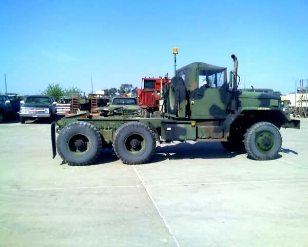

Hi all! I am the fabricator / builder for our all volunteer fire dept and am starting on a 5t 6x6. Anyone else out there with experience on these? I have a pretty good idea what I am going to do but am always open to new ideas and nice little tricks that others have found. It will mainly be for grass and timber fires. I am planning on a 1600 gallon tank with a 100gpm @100psi pump and will carry 300' of 1" hose. [IMG]Click the image to open in full size.[/IMG]

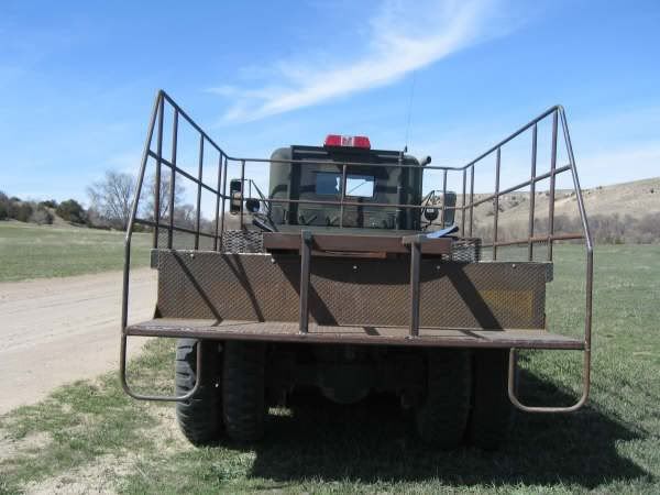

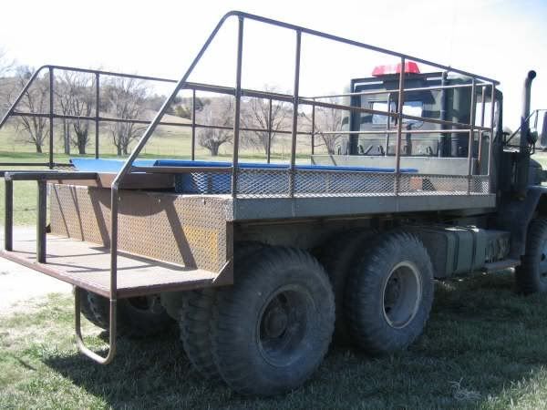

An update on the build, here are a few pictures before it goes to paint.

looks good so far. i would agree with the 1600 gals being too much. any way to mod the tank down to maybe 1000 gals and add a foam tank? check out http://www.steelsoldiers.com/ lot of good info from those guys. i want one for personal use but i want to bob the rear. take out the front rear axle and put on a shorter bed.

Thanks for the reply. We have other trucks running up here with 1500 gal tanks and are getting along okay. The reason we went with the 1600 is I got 3 of them for free. See how it goes and can always get a smaller tank if we run into trouble. Have you considered going with an ex-power company 4x4 truck. Like the ones they use to set the big poles? Might save a lot of modification.

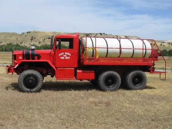

She's ready to go to work except for a few small things. Had it done in time for the fire season, just took a while to get the pics in. It is very dry here and we are expecting a busy summer with many fires in the surrounding districts already. Thanks to all for your suggestions and help.

Very nice job! This is what our state forest service builds then contracts out to the counties departments. We get to use them for regular calls, but we must have a crew ready to respond for large incidents anywhere in the country.
1000 gallon low profile tank. they handle great, and having the weight low really makes traveling slopes easy.
Here is one me and the former chief built, also 1000 gallons.
Have you considered spray bars? We have them at all 4 corners on the white on, and on each corner of the front on the USFS rig. They are controlled by 1/4 turn valves inside. They make ground cover fires a breeze! You can control the flow and reeeeeeaaaaaly conserve water, and if you run the flank while controlling the valve, you can run for a few miles on a tank of water.

Those are 2 fine looking outfits FireCop. Yes, spray bars are in the works. I built two ports in the manifold for them and am planning on being able to operate them from the cab also. I think they would be real ticket in some situations. I am looking around for some nozzles that will do what I want them to or maybe just make them myself. What did you use?

We buy them from the Colorado State Forest Service, and I'm not sure where they buy them. They are brass, 1" thread, and have a notch cut in the side towards the top. The notch is at a slight downward angle to make a nice 90* fan pattern that aims down slightly. At the department I was on prior to this one, we made some out of pipe cars, and cut the notch in them ourselves. They worked well for what they were.
Again, nice job! The fab work looks great, and the finished rig looks like it has a lot of tool and appliance storage area.
